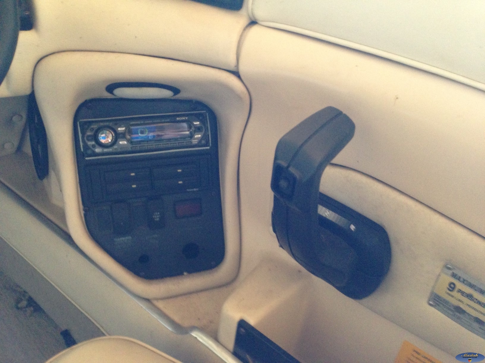

    What shifter do you have?
    Got a pic of it?

    Default Re: Tilt/Trim
    Old 07-09-2013, 02:43 PM   #6
    Quicksilver 3000.
    Trim switch #87-18286A41
    $48.00 @ mercruiserparts.com
