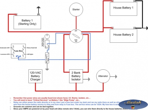

    Here is a drawing of what I did in my Z222. Originally came with 2 batteries.

    Ok, Ive decided to go with 3. The new deep cycle I bought was bigger than the standard battery so I have to buy a new battery box and cables. Ill do a 2 start and 1 house (deep cycle). Do I have to have and Isolator or can I run the 2 starters batteries together and the house on its own? Like the diagram above minus the isolator and charger.
    You have to keep in mind that you need to charge them. Once you land the charging system on 3 batteries they become as one. The isolator prevents the house batteries from draining the starting battery.

    Correct... Im going to install the isolator and set it up like yours but Im going to have 2 starting and 1 house. Like z275st said, better a dead radio than boat! 1 deep cycle should run several hours of radio and phone... I also saw a post of somebody taking out the inline fuses and putting in a fuse panel. My 00 272 had that set up. Im going to do that too. You have pics of how you mounted all your items?
    If you look at the drawing the fuse panel is one that I installed under the console on the starboard side bulkhead. That is where my stereo, GPS, LED and power accessories are landed.
    Leave the bilge pump and power hatch (if equipped) on the starting battery. IMO... The 2 starting battery idea is an overkill and waste of a good battery. If done like the drawing, you should never have any issue with the starting battery. What I did is when I purchased the new battery, it became my starting battery and the 2 old ones became my house batteries. Additionally, with the setup as I have it you can link all 3 batteries together in a pinch which after 4 years I have never had to do. I can play my stereo and have my LED lights on for at least 4-5 hours and never had an issue.
