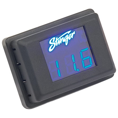

    Depending on the complexity of the voltage monitoring, it can be as simple as a few resistors, a transistor and a lamp/LED. The easiest solution is a ready made voltage monitor/gauge. Here's a couple made for motorcycles, but should work just fine in a boat:
    http://www.customdynamics.com/LED_battery_gauge.htm
    Another option is an actual digital voltage gauge. I went this route for one of my bikes since I had one left over in the garage from a stereo install I did a few years ago (I had blue on hand, but they also make them in red):
