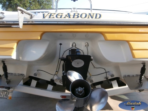

    Drilling these into my boat was the most nerve wrecking project ever but once I did the first one, the rest was easy. I even mustered up the nerve to drill in my underwater LED lights... Go for it...
    By the way... Go with what the selector guide recommends. These are easily adjustable to your liking. It took me two adjustments to get the performance I wanted.

    Default Re: Smart Tabs
    Never seen Smart Tabs mounted that way and work properly
    Nauticus doesn't recommend mounting the actuator in that position.
    Does it do ok? Do you have rooster tails off of the tabs?
    Just seems weird to me.
    Muggi , don't put 80 lb actuators on your 212 , if you'll do a search , members with the 212 are running the 60s after trying the 80s to their dismay.

    Nothing wrong with the mounting the way it is. It is the alternate mounting requirement per the instructions. Works great...
    Uhh ,
    Just noticed , you are running the ST tabs.
    I wonder why they say don't mount the SX tabs that way , but fine to mount the ST tabs that way?
    I bet you do get a better "flat turn" with them there anyway.
    No wake zones should be way easier too.
    Interesting.
    Think I'll call them and get the lowdown.

    Here is what Greg from Nauticus sent me:
    "The STs can because the way the actuators mount. The SX are molded and the fitting on the actuator will bind if it is at too sever of an angle. This is because it uses a fork style end fitting an the ST tabs use a swivel one."

    If I knew that I would have got the Sts so I could have mounted them all the way .to the outside. But I must say mine works pretty good in the standard Mariah position
