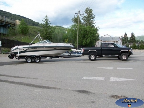

    what do you guys think of the combo gotta be six stalls i figure

    Good looking combo there Lance! What size lift is on the truck? Does it affect towing at all?

    it does affect towing alot, it did the job from calgary alberta to vancouver island last year and with gas prices it was about 800 dollars....one way, i am towing the boat back here and when i do i am gonna put the regular tires on i know it will look wierd but it will save on gas and my transmission there r alot of steep long hills in between, so i prepared the truck for that i put on a heavy duty transmission cooler, throttle body spacer cold air intake and a jet chip with the truck only bein a 1500 sport package with a 5.7 litre 360 v8 it is still alot of boat, i wish i had a new twin turbo diesel but for now i will stick with this and when i switch the tires back i will get all my original power back which was quite alot, i figure i lost about 30 percent with the tires that are 35's, and the lift which is a five inch lift

    Switching tires down might be a good idea for a long tow, but if you wanted to keep your current tire size, and planned on keeping your truck for a while, maybe you could get it re-geared? I'm assuming you're running stock gearing, I can't remember if it's 3.54 or 4.10 on the 5.9L. In which case, stepping up to a higher gear such as 4.56 might be really beneficial. Re-gearing is a great way to bring everything back to stock driveability if you've added larger tires. When I had my lifted Wrangler, I had it regeared to 4.88 and it was a night and day difference. Even running 33 and 35' tires seemed like I was using the OEM tires. Gears will run you a few hundred per axle, and then you'll have to find a 4x4 or specialized truck shop that can install them. I highly suggest Yukon Gears from Randy's Ring & Pinion. I had great luck with mine!
    Good job on the transmission cooler and aftermarket parts. I'm sure that'll add some pulling power, and keep things cool while towing!
