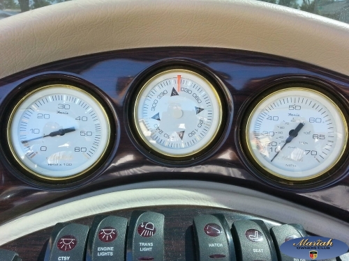

Not sure if this is normal and certainly does not seem normal to me but every time I shut the boat motor off the RPM gauge stays at 500-800 RPMs and will stay like that until I start her again next time. I don't remember this last year but I don't know for sure...
Is this something to worry about or nuisance issue?

    There is a weak magnet built into the air core meter movement that is supposed to return the gage back to 0 with no power. Does your gage go to zero when power is applied but the motor is not running? Do you have anything with a strong permanent magnet located near the tach?

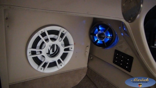

    Ha! I think your on to something... one of my Memphis 12" subwoofer is directly under the console... Ironically my compass has never worked but I am guessing that the subwoofer wouldn't let that work either. Interesting I just noticed the RPM issue but have had the Subwoofer installed there 4 years now.
    Hmmm... Anyway to shield this from the sub without adding a lot of weight?

    As long as the tach operates normally with the ignition turned on...I would just leave it alone. It would be rather difficult to make a magnetic shield over such a strong magnet. You would need to use a good magnetic conductor like iron which rusts or even better a mu-metal alloy which is expensive and difficult to source. At least you know what's going on now.
