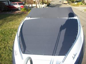

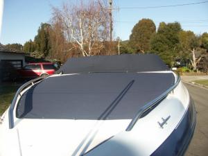

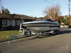

    Well, I had the Bow Cover and Windshield trailering protector made. Here's how they look.
    The windshield protector has dense 1/2" foam sewn in with Sunbrella on the outside and Car Cover material against the glass for the front and just Sunbrella on the sides. The top edge has Gypsy snaps so a canopy cover can be attached later.
    Total cost including tax was a little over 5 bills for both, but I feel it was well worth it.
    Now I have a little more piece of mind when trailering, I won’t be worrying as much about the windshield getting damaged as I believe this would be one of the most difficult parts to replace.

    Lookin Good Willy! Man, that's a great deal for all that canvas work!
    Old 02-06-2008, 12:11 PM   #7
    Yep, she looks good! The one thing i did differently with mine was that i extended the cockpit/windshield portion down so it actually attachs to the bow cover with a zipper & velcro. That way the rain water doesnt sneak into the bow thru the opening and if i'm pulling the boat in the rain, the wind doesnt force water up underneath the windshield opening etc. I saw it done on a Glastron & the owner said it worked great.
