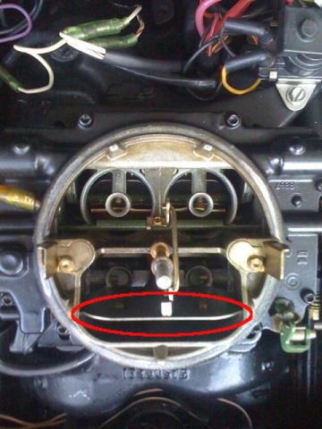

    If, by "flapper," you mean the rectangular thing over the carburetor primary throats (the two smaller one in the "front" of the carb), that I've circled here:
    it should probably be connected to an electrical choke control, because, you see...
    Originally Posted by Zackattack View Post
    Another question I have since on the topic is where is the choke? and how do you activate it?
    ...that's the choke .
    As far as to what it's (supposed to be) connected, and how: There I cannot help you, as I've never closely-examined the choke linkage or electrical choke system on these engines.

    I figured this was the choke mechanism, what i meant was what controls it and how is it activated? It just is connected to a control arm that disappears under the carb. So it likely is just heat controlled and therefor automatic. That seem to work fine.
    As I wrote: On newer carbureted engines, they're mostly electrically controlled, as I understand it.
