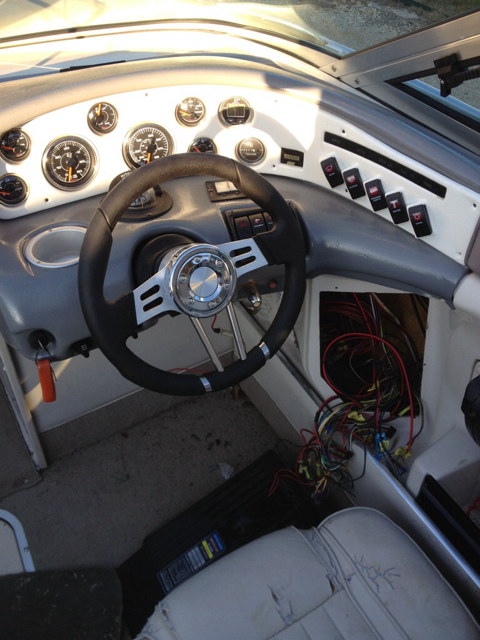

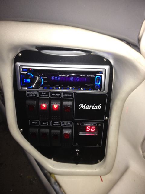

    The dash panels are a very hard to find item, like Mikey says. I opted to do repairs on mine on my talari 240z. I had a few cracks that I repaired with epoxy and sanded smooth. Reprinted with an adhesion promoter and plastic spray paint and they turned out like new. I have seen the stereo bezels on eBay, but I had a guy custom make me a new one. A bit pricy, but he does excellent work and can custom make them for whatever switch arrangement you want and has backlighting, too. If interested, pm me and I'll send you his contact info.Dashboard wanted, Talari 240Z-imageuploadedbytapatalk1405684568.648313.jpgDashboard wanted, Talari 240Z-imageuploadedbytapatalk1405684601.403396.jpg
