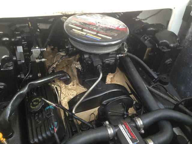

    Here is what it looks like now. Not to mention the 5 gallons of water out of the block I drained. also the 5 gallons of wiped up oil and water coming out the drain plug.
    I can only hope a shot gasket but I have to say I'm sure its a cracked block do to poor winter storage I'm thinking.
