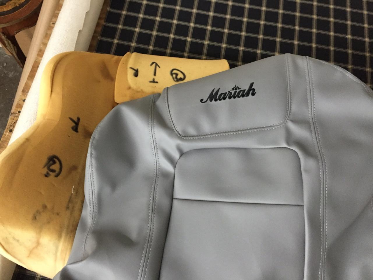

    Just finished my seats today. I'll post a pic after I install. I had to replace the whole back hatch and seat. I would suggest finding a "marine" upholstery shop for the job. I own a upholstery shop but only make custom residential furniture. Figured it would be easy but everything had rot and most of the fastener's weren't stainless steel so everything just fell apart.... Fabricated everything with marine plywood and all stainless hardware and staples. Also they didn't use Dry Fast foam so if anyone does Reupholster their boat you should ask about the foam and request stainless hardware.
