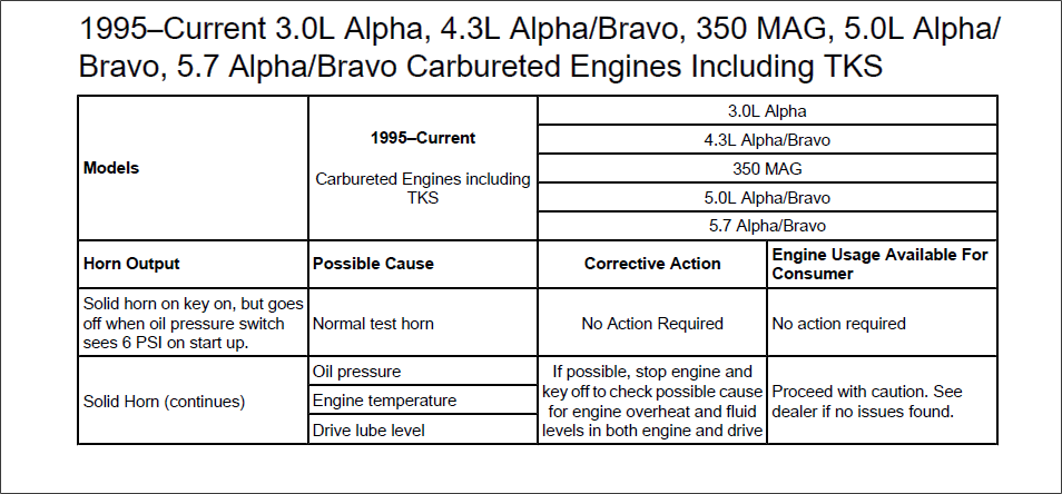

Ken.... These are the Mercruiser warning horns for your boat;

    Damn that horn is not going to stop before startup.

    Check you lube level? Oil pressure sensor? Temp sensor? Might be an easy fix.

    I think the horn Ken is referring to is the normal test horn at start-up. No bypassing that ....
    See my post #11 for reference.
    That is exactly what I am referring to.It is SOOOOO loud

    On the construction site we put electrical tape over the beeper horns on scissors lifts to quit them down but not eliminate them. Not sure were the horns at but if you can cover it with something like tape or some cloth it will take the bite out of it.
