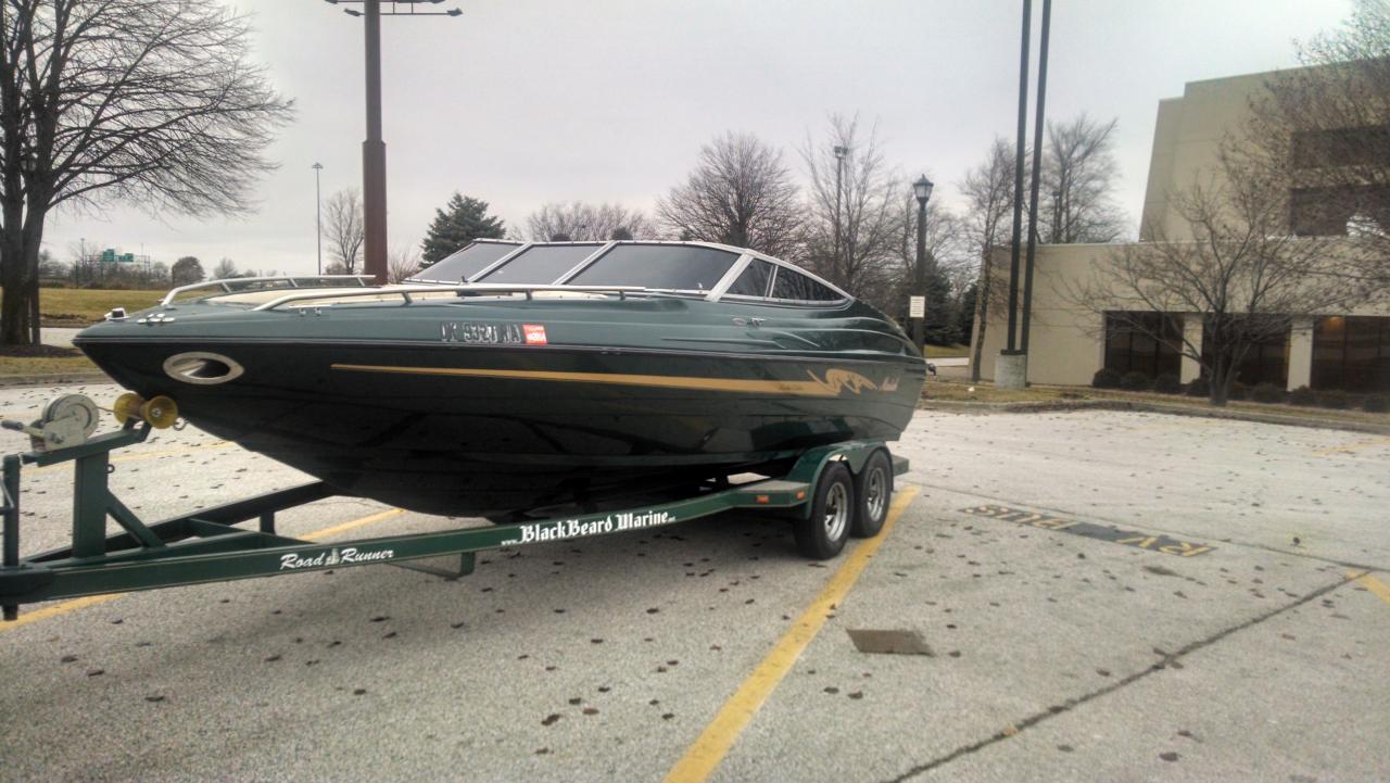

Hello all. I just purchased my first mariah. I have been looking for this boat for about 4 years since I first saw one. Final came across this 1998 shabah z222 l.e. With only 234 hours on it. It needs a few things but for a 16 year old she's in really good shape especially the interior. What I would like to know if the power anchor light is what is supposed to be above the gas cap. There is something there but it's broken off. Any help would be appreciated. ThanksAttachment 5822

Can you post a pic?
The power anchor light sits flush on the top of the gunwale at the transom, and has about a 2" circular base.
